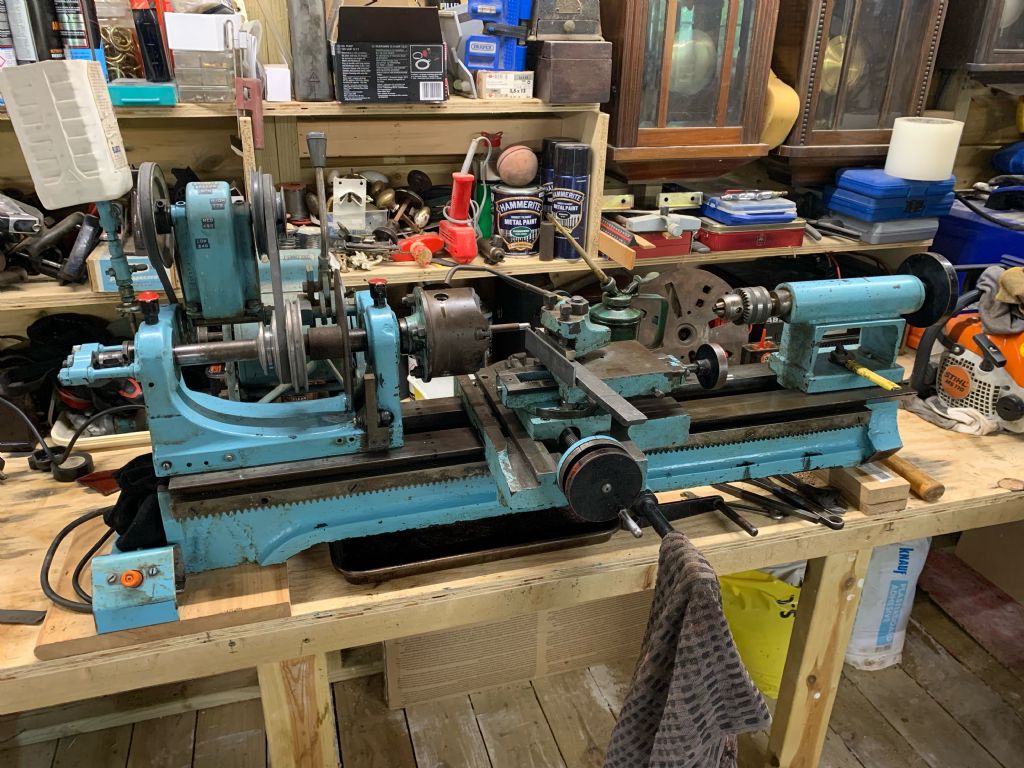

      Picked this old lathe up yesterday no makers marks or anything at all on the lathe it has got Picador England on the countershaft but the fixing of the to together looks home made so i dont know if originally they would have been a pair, fitted with a 5 inch chuck and a 4 jaw 6 inch came with it runs silent and sweet, was told it had been removed from a RollsRoyce factory when it closed a faw years back and been stored since, looks like it should of had legs or feet and something is missing from the headstock side any ideas please

        anybody know what make this is
        #603566
          The Picador unit was a standard commercial item, so possibly a ‘Red Herring’ in your search.
          Lathe headstock [almost certainly] was a flat-belt design, with substantial pulleys, and I presume from the thrust-bearing arrangement it is of great age.
          Sorry … that only gives you a couple of pointers, and is not an identification.
          Happy Hunting !
          P.S. __ some more-detailed photos of that headstock might help … it looks like it originally had a backgear

            Certainly a hotchpotch of curious bits
            The headstock has no spindle bore and is missing a lot of parts and for some reason the rack extends the full length of the bed
            What remains looks like good quality gear but a lot is missing

              That outrigger thrust bearing arrangement on the end of the headstock spindle is very turn of the century looking. Tailstock looks to be fabbed and welded from steel channel and bar at a much later date. V belts and counter shaft obviously a later addition too. Rack length is very odd. Has the bed been cut down from original length? And no sign of a leadscrew or brackets for it.
              The shape of the bed is almost like a gap-bed lathe that has had the gap cut off it and the headstock moved along to the main part of the bed, which would explain the location of the rack.
              If it came from Rolls Royce it might have been Henry's original lathe. Certainly has had a chequered career of some sort by the look of it.

                Looks like the tailstock is a welded fabrication

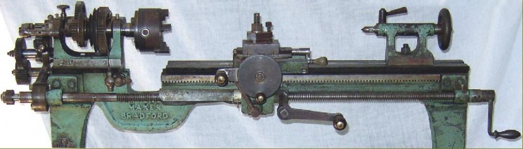

                  Possibly a turn-of-the-century Milnes that has had the gap bed cut down and headstock moved along on to the main part of the bed. LINK
                  Has very similar distinctive crank handle for carriage rack traverse and the large disc cross slide handle.See the pics of the greenish lathe further down the linked page.

                      Looking more closely at that bed, I think it probably had an integral pedestal at the headstock end … and somebody salvaged the useful and compact part.

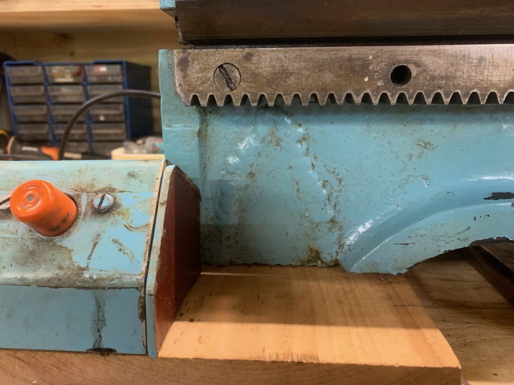

                          Thanks guys the links are very interesting for sure looking at the bed there is some weld marks i will see if i can get a good picture and a closer headstock pics

                              My guess is someone talented with access to a workshop and no money got hold of an elderly worn out machine and made a useful plain lathe out of it.
                              The bed has been sawn off and the missing feet suggest it was originally part of a larger casting. Two reasons for sawing off:
                              • the need to fit physically into a home workshop, perhaps reducing both size and weight, and/or,
                              • to remove the worn part of the bed. (A great deal of lathe work is done with the saddle sliding to and fro immediately in front of the chuck. That slowly wears a dip in the bed that eventually makes the lathe unusable, even though the rest of the machine is OK. Bed can be reground a few times, but such machines are usually scrapped.)
                              I think someone has sawn off the end of the original lathe and moved the headstock to avoid the damaged area. Looks like they had to make a tailstock and adapt other parts as well. Lots of changes, and probably parts from more than one machine. Missing bits too: the original may have been a screw-cutting lathe with gears on the end of the headstock and a lead-screw: possibly this was all too difficult to refit after shortening the bed, or maybe the owner didn't need screw-cutting.
                              Result: a working plain lathe. Acid test, 'does it cut metal?' As it's lasted this long, I expect it does! Has it been tested yet?

                                  It's the only reason I can think of that the rack goes all the way to the end of the bed. In fact it doesn't — the end of the bed has been brought to the rack! If you look at the below Milnes bed, if you cut it in a vertical line from the end of the rack, and then in a horizontal line just at the bottom of the leadscrew, you would have pretty much the same shape as in the OP.
                                  And you can see the V weld right there on the OP pics, so maybe the bed had been smashed up and salvaged? It happens. A mate of mine just bought for $50 at the scrapyard a Hercus clone of a South Bend (ala Boxford) that had been dumped off the back of a truck at the scrappie's and the bed snapped right about the same place. He bought it to salvage the headstock and other bits. But he could do this and cut the bed down and use it as a very stumpy lathe.
                                  The above pic too shows the weird crank handle on the carriage and equally unusual big disc on the cross slide handle. Note the black horn and brass handles on the crank and cross slide etc look identical to Drummond M-Type. Wonder if they came from the same supplier?
                                  Yes I'll bet there's many a good story that old machine could tell as Dave says. Quite possibly starting as early as 1890 so a long and multi-faceted career!

                                    Hi guys here's some more pictures in the album close up this one shows the weld i think by the looks everybodys right the bed has signs of welding at the gap part of the bed that was still lease the bed at just over 4ft tho, yes it cuts nice, the 2 locking rings at end need to be replaced does anybody know where i can lay my hands on two..

                                      thats it thats the one right there just put up picture of the welding

                                          The whole machine has the signs of having been salvaged from a damaged / derelict machine..
                                          Certainly looks as if the bed has been shortened both longitudinally and horizontally, and the Tailstock, as already pointed out looks to have been fabricated.
                                          In my view, definitely a "home brew" , based on a very old lathe, but probably by someone who knew what they were about.
                                          Maybe it was scrapped from R-R because of serious damage and brought back to life afterwards

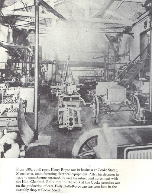

                                                    It would have fit right in at the original turn-of-the-century Rolls Royce factory. Somewhere up the rear left-hand corner somewhere. Maybe if you squint you could see it?
