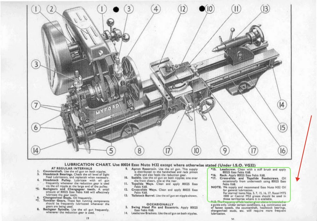

      I know its probably been asked here before, but from what I could tell last time I checked is that you need H32 grade on the drip feed oilers and use it on all the oil nipples found around the lathe, and the more "sticky" K68 grade oil goes on the feedscrews and leadscrew shaft.
      Since its quite hard to apply oil under the cross slide, is moly grease OK to use?
      Im surprised that oil is actually used on the feedscrews, I thought it would run off rather easily. I think I read something about it lets swarf stick to it.
      I get that with the leadscrew on the front, but on the cross slide and top slide, they are protected and it doesnt easily get under it to get in contact with the shaft.

                            #560220
                              From the Beeston Horse’s Mouth :
                              Sorry, that’s the best copy I have … Click image for larger view
                              Edit: __ This is very helpful [downloadable as PDF ]
                              https://www.haythornthwaite.com/184%20Myford%20Lubrication.pdf

                                Thats extremley helpful thanks, and it confirms what I had been thinking. Note how it says to use the moly grease on the starred items if available in your area. This includes the feedscrews as well as the main leadscrew.
                                Since that its so difficult to reach the feedscrews easily, i think the moly grease would be a good option, especially since they are largely protected from swarf.
                                #560226
                                  Posted by Shaun Belcher on 29/08/2021 08:02:27:
                                  Yes, I marked-it-up specially to draw attention to that angel
                                  Hopefully … if someone has a hard-copy of the Myford ML7 book, they might share a better scan.

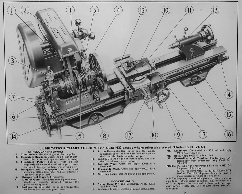

                                    DiogenesII
                                      @diogenesii
                                      Posted by Michael Gilligan on 29/08/2021 08:15:12:
                                      Hopefully … they might share a better scan…
                                      ML7 LUBRICATION
                                      ..There's a full-size copy in my 'Misc' album..
                                      If you are as committed as you sound to the machine, it'd be worth buying a hard copy manual – although superficially a thin volume, there is some useful information in there…
                                      (Canon G9X processed in Photoscape)
                                      Edited By DiogenesII on 29/08/2021 09:35:44
