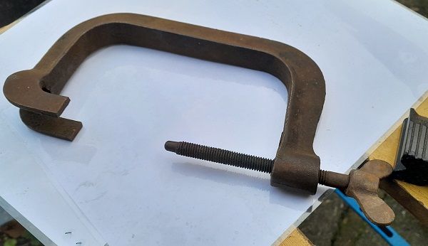

      Looks sort of G-clamp-ish but not. The screw is about 6 inches long and doesn't go all the way to meet the fork bit, which is about 1 in wide. Looks like maybe a bit is missing.
      Probably automotive? maybe like a valve spring compressor?
      Can perhaps repurpose it into something useful but curious if it has a better, original, use.

          It's a valve spring compressor

            I would also say valve spring compressor. I have one a bit like that which did actually start out as a g clamp….

              A bit of wood under the pointy bit and the fingers on the collet holder

                An over tightened one! Probably for a bike

                  I have one, purchased as and used for compressing valve springs. Used to remove valves from any cylinder head which will accomodate it. The treaded end engages the valve head and does not require a protective button. Valves are hard, the thread is soft.

                    More likely a car butcher!
                    I suspect it has been used as a G-clamp.

                      I have had valve collets that are reluctant to let go but a tap with a mallet after tightening the compressor usually releases them, saves distorting the compressor.

                        I always give the valve caps a tap before even getting the compressor out of the box. Saves a load of effort.

                          A valve spring compressor. I have one identical which I bought in 1970 at a bike shop in Winnipeg to remove and install the valves on my Norton 750 Atlas bike.

                            So no missing part – thanks. I might need it one day then I guess, even if only for dismantling an engine to get the aluminium for casting.

                              Looks like an old one, intended for use on side valve engines, but could function equally well on a pushtod engine.
                              OHC may not be as easy

                                  Unlikely to fit in the valve chest, My side valve spring compressor fits in the chest and only compresses the spring. It does not exert any pressure on the valve. It resembles a pair of spring compasses with forks on each arm which are slid on the the coils top and bottom and the screw with butterfly nut tightened to compress the spring. Side Valve cap security methods differ the simplest being a cap with a slot which slides into a groove in the valve, the dished perimeter of the cap bearing on the valve holds everything in place.
                                  As regards OHV and OHC I have already stated it will compress valve springs on any accesible cylinder head rather than every cylinder head.

                                    Common-a-garden OHV valve spring compressor that every mechanic shop used to have at one time. Looks much more solid than the more recent ones that are made from two pieces of stamped flat steel riveted together and tend to flex about a lot in use. That one with the cast rigid body is a good 'un.

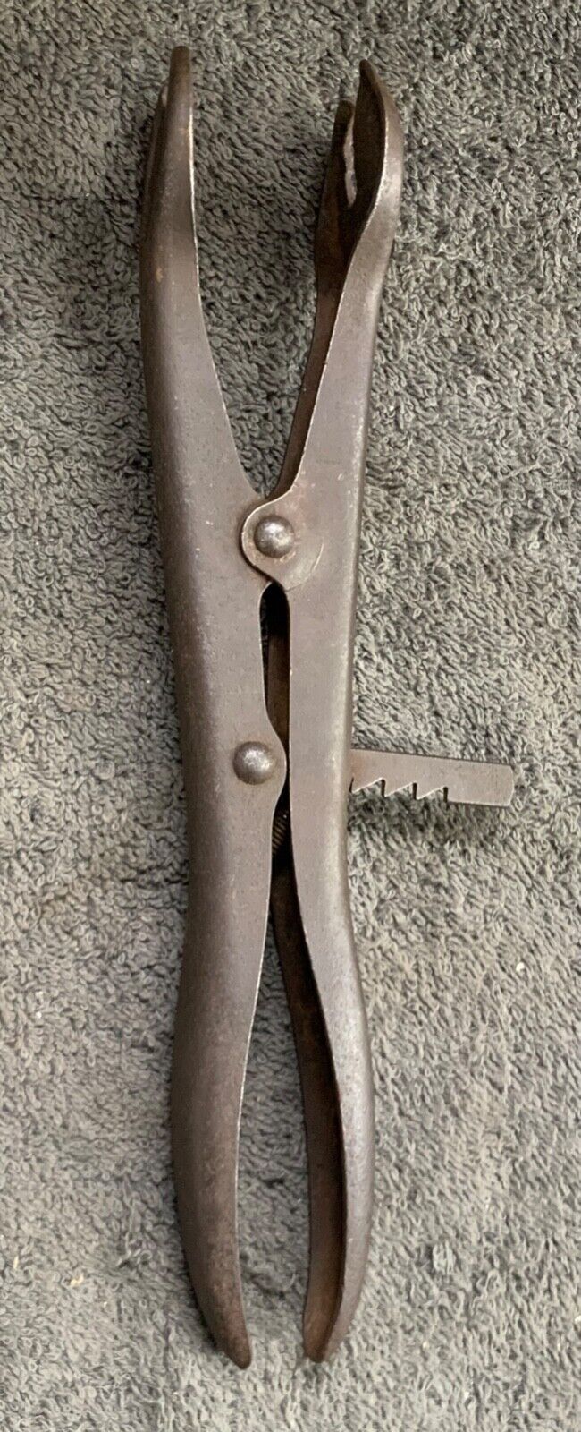

                                    This is the type of compressor we use on side valve Harleys to whip the valves out without removing the cylinder from the bike. It slides in from the side below the spring and lifts the valve collar upwards:
