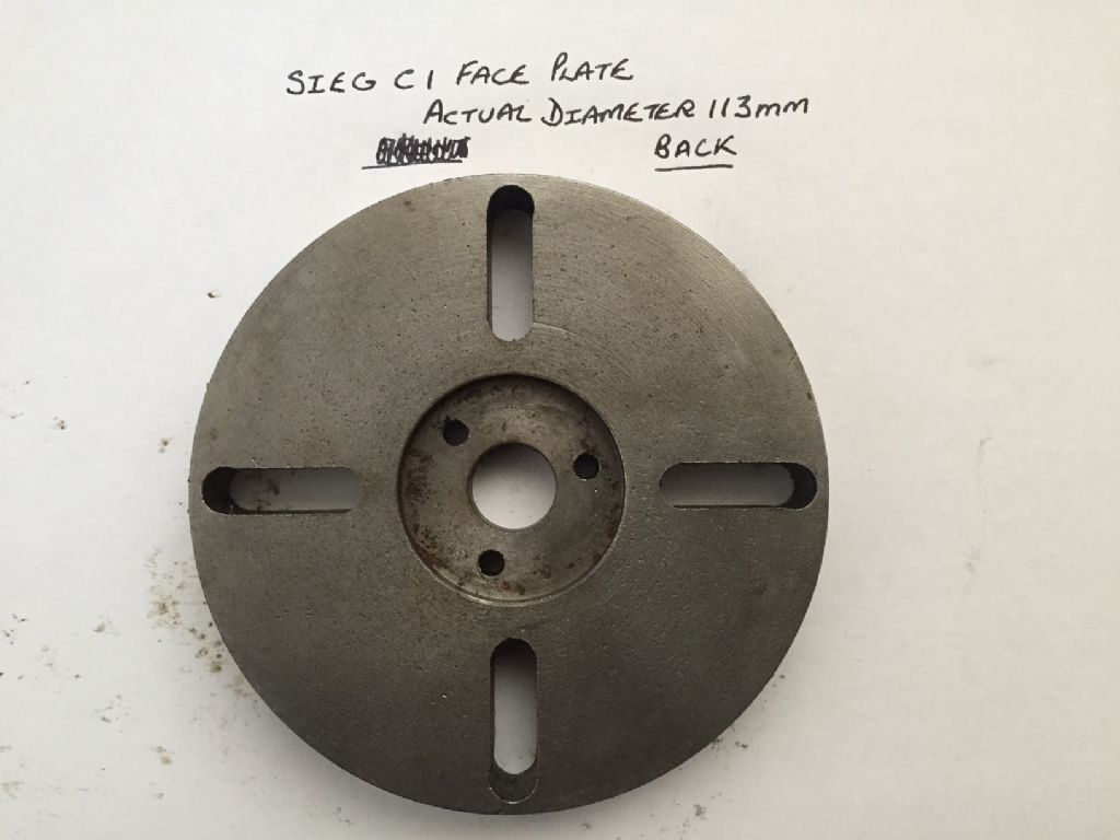

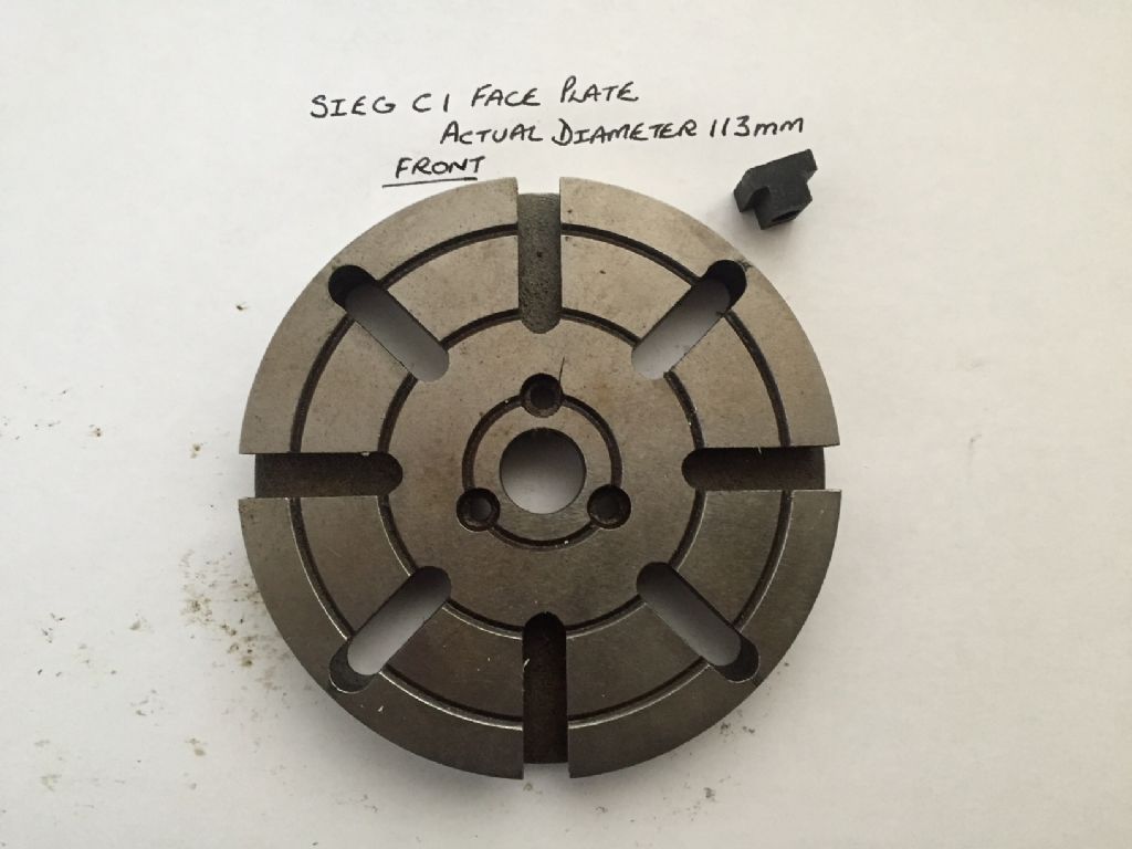

          Possible Plan B, depending on the measure from the centre of the spindle hole to the chamfered edge of the motor housing.
          SIEG C1 lathe faceplate is 113mm diameter (even though it is stated as 110mm, which is nominal diameter): http://www.axminster.co.uk/axminster-sieg-c1-110mm-faceplate
          ARC does not sell it, and nor does Ausee. Hope Brian can find in Australia, if he decides to go down this route and if someone is able to assist him for the modifications needed. It may be a route which Brian might want to consider if the faceplate diameter fits his machine.
          Please see these pictures:
          – Current register on the back is 40mm. This needs to be opened up to 55mm
          – From the front, the four through slots could be used to mount the face plate to the four holes in the spindle flange (66mm PCD hopefully), using screws to suit, may need to countersink?
          – The T-slots are 8mm wide, which will accept M6 T Nuts.
          Ketan at ARC.

              Ketan Swali
                @ketanswali79440
                Not sure Neil.
                Looking at Part 16 – Exploded diagram 8.2 in the manual, suggests that it has mounting holes for 3 hole and 4 hole mounting. Brian will need to remove the current backplate to check PCD, hole arrangement/s and spindle flange diameter.
                The same diagram also shows the backplate only having three holes for mounting 80 mm chucks, where as Brians picture shows more, enabling mounting of Chinese 80mm 4-Jaw independant chucks which have four bolt mounting.
                Alternatively, Jasons suggestion with Ali also sounds good.
                Ketan at ARC.

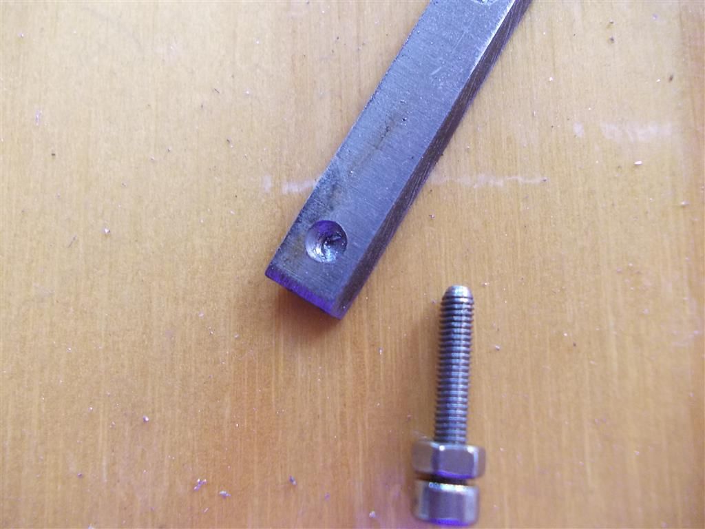

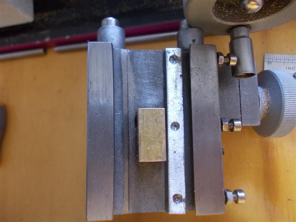

                                              I had a look at the cross slide today because it is really becoming a nuisance to have to adjust the gib screws whenever I move from the centre to the outer limit closest to me. I removed the back screen , undid the gib screws and unwound the cross slide until it slid completely out. The gib screws were flat so I filed a bit of a point on each one with the flat of a diamond wheel in the dremel tool. There was a rough edge around the dimples on the gib where they had drilled the dimples so I filed these flat to remove the rough edges. I removed all the swarf and oiled the moving parts.
                                              After putting it back together, it is a bit better then before but still not great. I am not sure what else can be done. I may have to live with it. I do not do up the lock nuts on the gib screws anymore. I need to be able to adjust them quickly depending on where the cross slide is ie. loosen them off when in the centre and tighten them up when closest to me.
                                              NOTE : the gib can only be fitted one way so no problem putting it back together incorrectly. I am still looking at ''dowelling the gib'' but I have to be honest here  in that I do not see how it helps. I  must be looking at it the wrong way !

                                              #208055
                                              mahgnia
                                                @mahgnia
                                                Brian,
                                                It may just be the casting shape or the rounding of the machined edges, but the dovetail on the cross slide looks curved in those pictures, especially on the side away from the gib.
                                                Are you able to check for straightness?
                                                Andrew

                                                  Brian John
                                                    @brianjohn93961
                                                    Mahgnia : yes, it does look very curved on the side away the gib. Might that explain everything ie. why it is much tighter in the middle ? I may take it off again tomorrow and have a closer look. I must admit that I did not see it because I was not looking for it. I had assumed that they could machine the edges in a straight line !
                                                    John : I assume that machined edges are machined in a milling machine. What are ''ground'' edges ?
                                                    Edited By Brian John on 16/10/2015 10:10:41
                                                    Edited By Brian John on 16/10/2015 10:12:50
                                                    #208064
                                                    mahgnia
                                                      @mahgnia
                                                      Brian,
                                                      If you have a good stiff straight edge, you will need to check the straightness on all the faces of the dovetail.
                                                      Checking the saddle dovetail for parallel would also be a good idea. You can use 2 short round pieces that fit against each side of the dovetail, and measure across them at several places. The more accurately round and parallel they are, the better.
                                                      We shouldn't jump to conclusions without testing. However, if the dovetail is not straight the gib strip and grub screws would be the only thing holding the cross slide and toolpost steady against movement under cutting forces. It might explain many of the issues you've had.
                                                      John's suggestion to check the top edges of the saddle dovetail for clearance to the cross slide dovetail is also very important. The gib strip would also need to be checked for the same clearance at both the top and bottom edges.
                                                      Andrew.
