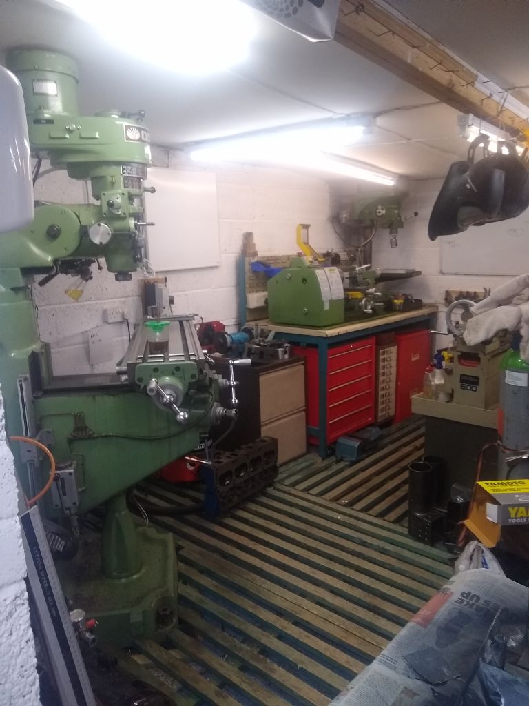

                                                  Robin Dufton
                                                    @robindufton85682
                                                    We've used Matt in the past to shift stuff and been very happy. https://www.1tonne.com/
                                                    You say it's 15' x 8' and have ruled out a large knee mill. The manual machine space in our workshop is that size and has two lathes, drill and a Bridgeport type mill. If the small lathe were gone you have bench space and our walkway is free space to put something like a saw. The mill cost considerably less than £2000 and is like new. It came from a company who repaired weaving looms that had shut down, and had spent it's life making small brass parts. Two of us moved it in our Transit van with an engine crane.
