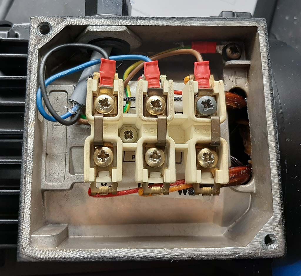

      The plot thickens. In the first picture of the motor terminals the motor is definitely connected in star. In the second picture it is now connected in delta.

        Posted by Andrew Johnston on 06/12/2019 18:40:24:
        Andrew
        If you look back you will see I mentioned I changed it

            Posted by petro1head on 06/12/2019 18:32:34:
            I had another look under the cover and noticed the area that looked burnst was in fact oil from my oily hand, that plus the white balance was wrong
            He is another photo
            Edited By petro1head on 06/12/2019 18:33:10
            Internet diagnosis is always difficult because of things like that. Difficult anyway. For instance, the small portion of windings visible in the photo look like they have been somewhat cooked, but that might be another trick of the light or even just the colour of the varnish.

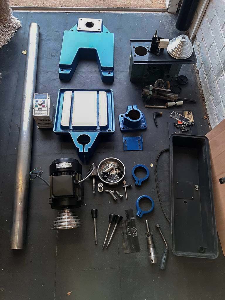

              Here is the drill in bits, slowly getting there

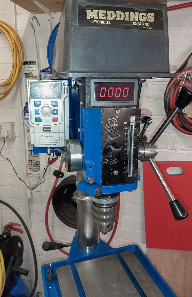

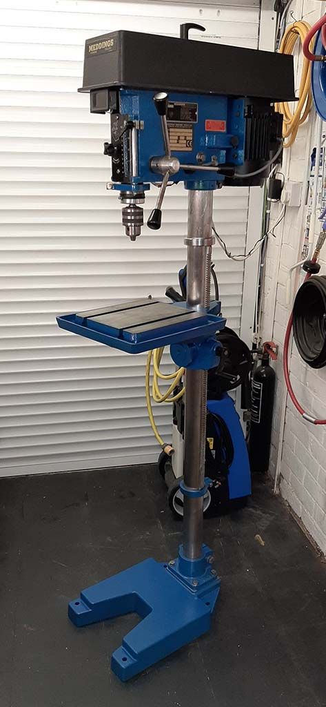

                                  Nearly finished, just need a speed control potentiometer
