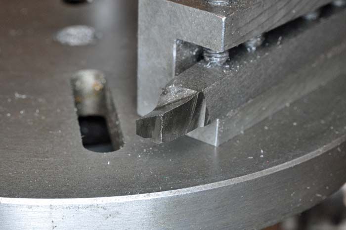

        Hi Guys
        Got a question for ya.
        keep in mind, this is NOT for a carbon insert and its for a old ish lathe with a max rpm of 1600
        My question is, how come they used to sharpen tool bits (and have tool holders) with a lot more back rake than we see now days???
        Tell me if I am wrong in my thinking,
        but try and scrape a stanley blade on some wood at a 90 deg angle to the wood,
        now tilt it some, its going to cut into the wood now where as before it would only be scraping
        is that not going to be the same on a lathe?????
        If not, why did they use a lot more back rake in times gone by???

          Less power. With higher rake the tool is 'sharper' and cuts more easily with low power, maybe only flat belts to transmit that power which are less capable than v-belts. However the side effect is less strength and less ability to conduct away the heat which dictate lower speed and more small cuts need to be taken.

                #314007
                Roderick Jenkins
                  @roderickjenkins93242
                  Piero,
                  Bazyle has summed it up very nicely. Don't discount the old methods, they are sometimes more suitable for our low powered amateur machines. If you want to shift a lot of metal quickly then a tool like this works very well:
                  Might not last all day in an industrial environment but dead useful at home.
                  Rod

                                Rake angles seem complicated but there is a simple way to imagine them when grinding a tool bit. A lathe tool always has a primary cutting edge (some have a secondary one too) which could be at right angles or parallel to the work – or somewhere in between – depending on its shape and intended use.
                                Looking at that (primary) cutting edge from above – the rake should normally run away from it at right angles. So for a parting tool – it will just be back rake and for a side cutting tool it will just be side rake. If the primary cutting edge is angled, then the rake will be a combination of both side and back. the cutting edge angle therefore sets the 'direction' of the rake and then the type of material defines the amount of rake (if any) required. Generally more rake gives sharper tools but shorter tool life.
                                Tools with just side rake are easier to sharpen in the sense that just the end needs touching up – but if some back rake is required, then an angled tool holder can also provide this without complicated grinding. Of course, a tool ground for use in an angled holder is ground differently to a tool held horizontally because the clearance angles are different too. The Tangential tool-holder is popular because it has a single face (giving both rakes) that is very simple to keep sharp by grinding.
                                Try Rod's (side rake only) tool and it will cut most things – but do use a flat topped tool for brass. Clearance can be ground by just using the curve of the wheel to give a slight undercut to the cutting edge…
                                Hope you can visualise all this – sounds complicated but it is easier once you get your head around it. As others have said, we are not in a production environment and the 'rules' can be bent quite considerably in the home workshop. Best way to learn is to grind a few tools and try them.
                                Regards,
                                IanT
