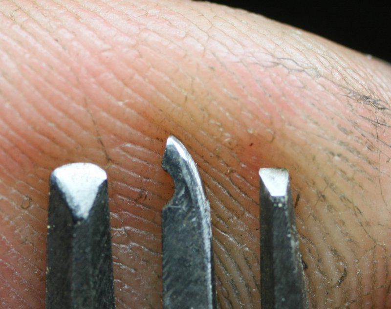

                  Let me change context a little. The majority of roughing out of this was done with a Magicut. Tricky to do this in a vice, holding the file with both hands – bench peg achieve the results quickest.
                  My point is that right-handers have more range of filing angle than left-handers when filing on a bench peg, and I believe this is due to angle of cut on teeth. If I file right handed then I can slide the file forward a bit rather than just go straight across, and this slide has it's uses. If I file left handed I have to go straight across or draw the file back towards me slightly which is a less natural stroke.

                                  Posted by jaCK Hobson on 19/11/2016 11:41:36:
                                  That thing is tiny!!! Wouldn't a smaller file work better? And some kind of filing jig to hold it?

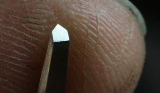

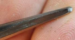

                                    I misled people. My example is obviously not 'engineering'. The scenario here is closer to jewelry, but everyone uses the same files so I should be able to ask engineers. I agree that if I have something in a vice or jig and I have two hands on the file then left handed isn't such an issue (but it is still an issue). But I believe there are valid scenarios where a left handed file would make a significant difference.
                                    All these were roughed out with a 12" Magicut then tweaked with a 4 cut 6". Developing the ability to adjust the form of the tool to the immediate requirements is probably important (I don't have the experience to comment) and you would need too many jigs.

                                      Richard S2
                                        @richards2
                                        Those examples you're making look like 'Graver' tools?.
