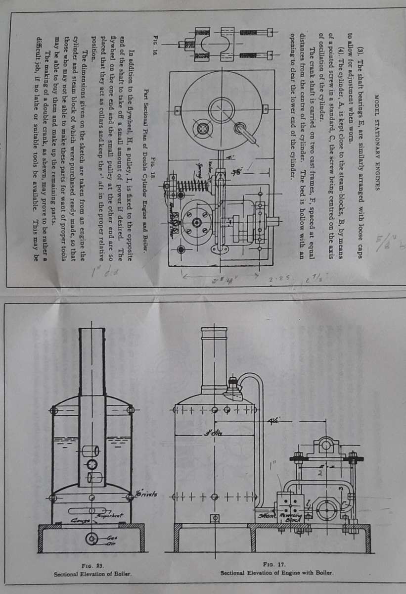

      Hi All,
      I am planning to make the two cylinder oscillator shown in the two diagrams. I have a similar vertical boiler which I will build into the model.
      I don’t anticipate too many problems in the build but I  am puzzled by one aspect of the design. The text from the author (Muncaster) specfies a crankshaft supported at each end by a pair of pedestals. This can be seen in 1/2 plan view of the engine. The center of the shaft approx 1″ long and 5/16″ diameter is unsupported. Why? This looks all wrong to me, but am I  missing something. Maybe something in the dynamics of the engine?

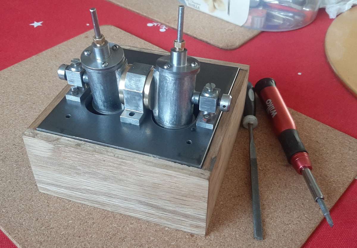

        It’s a lot easier to get a crankshaft running between two bearings than three, particularly given the equipment that the average beginner back in 1912 would have had.
        I also doubt that those little cylinders are going to put serious load into the shaft. Think about the high speed enclosed twin engines like the Stuart MTBs and Sirius all twin cylinder with no central support and they were good for 4500rpm and worked under load.

          IMG_0905
          Assuming you have the tools and the skill to get it all aligned … adding a third bearing seems a valid improvement.

            Thanks for the replies.  On reflection the crankshaft does look robust and would survive without a central pedestal.  I may cut apertures on each side of the platform leaving an area to fit an optional  “aesthetic” pedestal.
            From muncasters text I assume the cranks will be set at 90 to each other which with D/A cylinders will give a self starting engine?
            Is there any other reason why the cranks are set at 90?

              Not only starting.
              The 90º crank-setting was normal for twin-cylinder steam-engines, to aid starting in use albeit making balancing in manufacture, more difficult.
              Its other reason was to give more even torque per revolution.
              The maximum torque from one cylinder comes around mid-stroke, during the minimum, dead-centre, point for the other.
              Since the engine is both double-cylinder and double-acting the resultant torque approaches some constancy through the full 360º: a polar plot of effort against angle looks a bit like a four-leafed clover. The flywheel inertia smooths the curve to some extent, making such engines very good for driving directly-coupled dynamos and similar duties.
