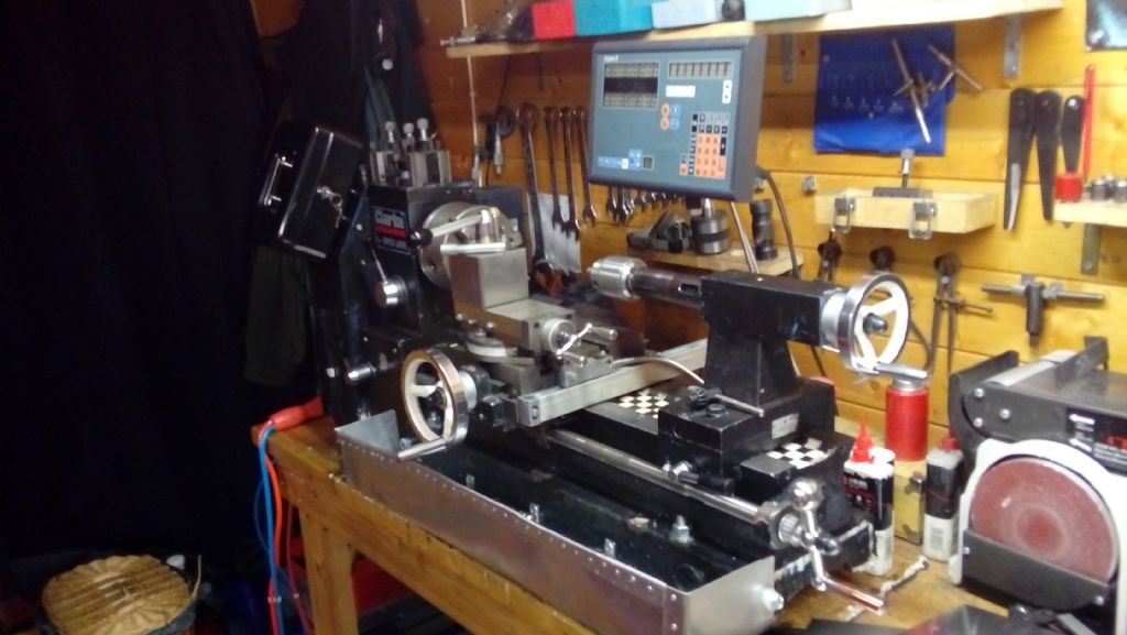

      So this is a glance at my machine as it sits today. I'm part way through building an aluminium chip tray as you can see. But it's also got a few other differences to the original, vital i'd say. I couldn't actually fit the rack and pinion on this because the tray blocks it's original position for the moment, the rack itself has been removed(and now I've lost it) but It's really simple enough to explain, I bought a straight length of 1mm pitch rack bar with a pinion from ebay and drilled 3 holes along the length, to which "fixing posts" were attached, the base of the posts needed to be angled because I figured I had the most room to play about on the base of the lathe, (so the rack was upside) and the cast face of the base is slightly off parallel by a few degrees. This ran the length of the base of the bed once it was fixed.

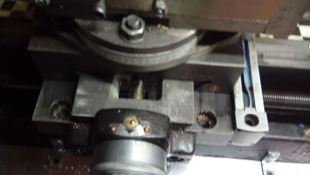

      Down below you can see part of what formed the next problem, where the hell do you attach an apron to the lathe? I figured the easiest and strongest way to secure it would be to remove the cross slide, mark out drill and counter sink two M8 sunken socket screws into the apron, this was adequate because it meant that nothing in essence was truly damaged by my workings, and it could be removed if I I didn't want it anymore, my number one rule of modifications is don't do anything you can't undo to your equipment.

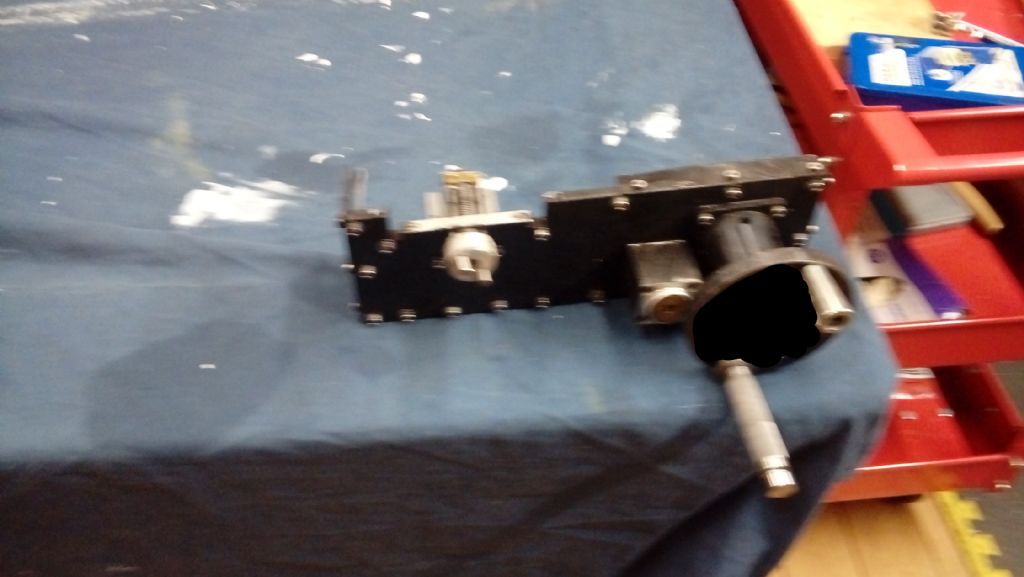

      lathe cross slide adapt.1.jpgSo now we come to the exciting bit, what I actually made this apron out of. I used a 1/2" piece of T6 aluminium plate, some myford gears I deprived from a potentially caring and loving myford user on an ebay auction that nobody seemed interested in. (got a full set of myford change wheels). and some silver steel bar.
      apron view.jpgAnd a close up of the workings.
      apron inner workings1.jpgSo I hope the gear train is fairly self explanatory what happens, I took the handwheel from another machine spare I had. That sits on some bearings. The little block you can see to the left of the traverse handle is a brass bearing block, because my pre-prototype proved 1/2" of support for the pinion shaft wasn't enough.
      To the far left you can see the disgrace of my build which was a kind of "wrench on" half nut that was truly awful to use. You can ignore that but there isn't a lot of space under there and things were getting dire at that point, the half nut is a slitting saw cut piece of a feed nut from Clarke spares, don't break too many of them as they are a little pricy.

          The legacy of all this amounted to bugger all in the end, I've never continued it, why? because in practice it was a bit of a dog in the surface finish department. I found one big problem may have been the gearing was a little too fast, it probably was traversing at about 34mm per revolution. I should note as well that once you remove the feed nut all this table has to hold onto in a cut is the saddle gib, so it's probably swinging from left to right in a very slight rocking motion with every movement.
          So what have I learned! It needed more support, a front fixing plate is no match for a full casting which is what most aprons have, the feed nut on the original helps to keep the movement of the lathe linear or straight, it acts as a guidance to give you nice even movement rather than jerking around under load. SO big thing I would do second time is to replace the feed nut with a slide fitting bush, which mimics the form of the original feed nut. This will do wonders for it's ability i'd imagine.
          You're probably all thinking at this point how on earth you'll ever get hold of a decent rack and pinion, gawd you're gonna have to run down to the engineering works and get on their case about some cooked up scheme you have. Guess what, you don't need one after all! in essence, you already have a perfectly good rack sitting right infront of you, introducing the wormwheel (courtesy of Wikipedia)!
          So You think about it your lead screw can carry a gear (sometimes two one above and one underneath). And advance at the steady pace of 0.6 pitch (you will need a different gear to the one shown so that it's radiused or bows slightly towards the centre of the worm wheel). Ok, it's not a complete gimme, but it's a start and i'm thinking this could forgo a rack altogether, obviously, I've still got one somewhere so that's what I might do if I have the courage to have a go again, but why not take the hint of a lifetime from ol' mike and save yourself some pain/ndrilling to your machine.(Theres a leadscrew clutch on the CL430 so it wont start moving every time you switch it on, should be noted that using a wormwheel would make it difficult to/ or atleast roundabout fashion to install a cross feed mechanism, so in that case a rack would work better, IF you wanted that. I was ever so simply suggesting a different approach to the same problem that could be considered)
          So there it is, my dirty secret. I'd ignore the half nut as an act of desperation but there could be some life yet if I gave it another go? Who knows?

            on your first photo of your chip tray coul you not move your lathe foward so the tray could hinge down over front of the bench it would make life easier for emptying,just a thought from my over worked braincell.Regaurding wormscrew find an old ajustable spanner
            Kevin
            #270348
            MW
              @mw27036
              That sounds pretty awesome actually kevin, I never looked at it that way. Were getting fancy now. Maybe I can put a little cigar lighter on there while i'm at it? It's crazy, but it just might work!
